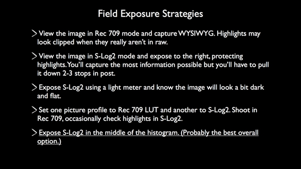

This is a list of the different ways you can expose images in the camera. All of them work.
Exposing while viewing Rec 709 mode gives you an image that looks great at the time but hides highlight detail, making it appear clipped.
Exposing while viewing S-Log2 and pushing the histogram to the right gives you the most information but requires the most correction.
Exposing S-Log2 with a meter works perfectly well but will result in a dark, flat image until it is graded.
You can operate the shot while looking at Rec 709 but set exposure viewing S-Log2.
What worked best for me was exposing S-Log2 in the center of the histogram. I captured a lot of information and the image still looked reasonably good on the LCD display.

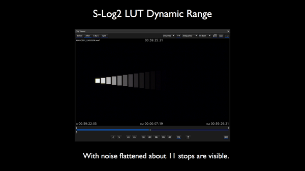

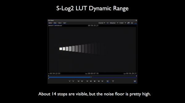

Getting back to our old friend the Xyla chart we can now see how much dynamic range we can actually capture with the FS700.

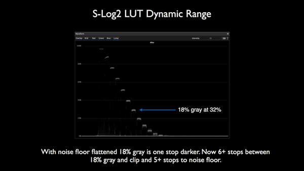

Noise severely limits the dynamic range of a camera. The more noise there is the more you have to crush it down to eliminate it, which means less dynamic range overall as well as less light sensitivity (lower ISO).

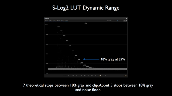

Pulling the gamma curve down a stop in the grade reduces shadow noise considerably, but the camera is now technically one stop slower in ISO rating.
It’s always a good idea to double check the actual image and see if it matches the waveform monitor. In this case it does.

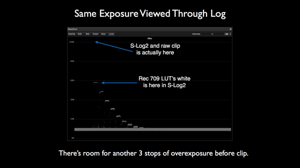

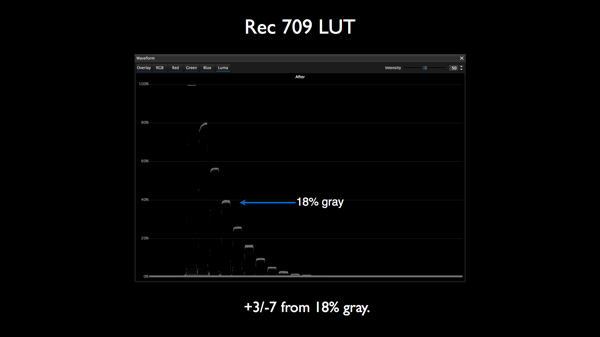

The Rec 709 LUT eliminates about one stop of dynamic range from what we’ve seen above, and significantly reduces overexposure headroom. If we take this same image and view it in S-Log2, however…
…S-Log2 gives us considerably more overexposure headroom for that “filmic” look.

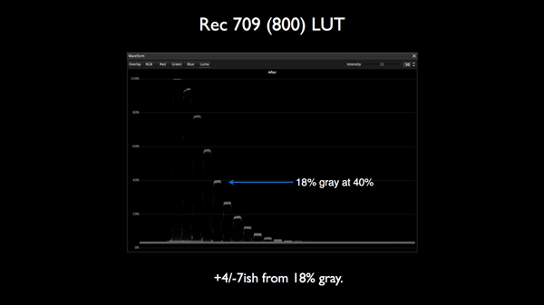

The Rec 709 (800%) LUT is designed to present a pleasantly contrasty image on a Rec 709 display while preserving another stop of overexposure headroom. According to this graphic it does’t look like it actually captures up to 800% reflectance, the way Sony labeled it, but it’s certainly better than regular Rec 709 itself.

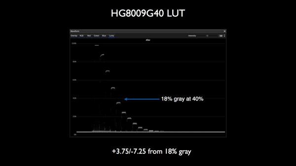

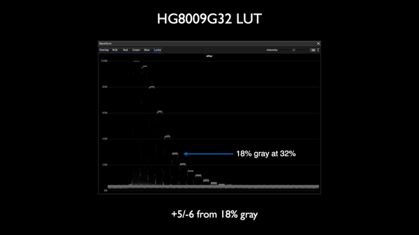

This hypergamma curve claims to capture up to 800% reflectance, and uses the full 0-109% offered by the Rec 709 spec. (Broadcast signals are clipped at 100%, so that extra 109% makes room for additional highlight detail that can be captured and pulled down later in a broadcast grade.)

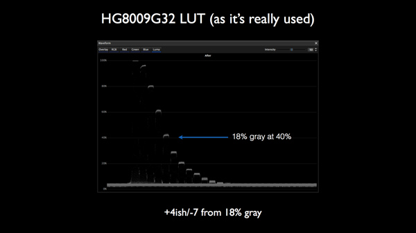

This hyper gamma curve places middle gray at 32%, allocating another stop of dynamic range to the highlights. In theory a colorist will pull middle gray up from 32% to 40% in post, but in reality…
…we typically use it as a what-you-see-is-what-you-get curve, so we only get a little more overexposure headroom out of it beyond what we see in HG8009G40.
