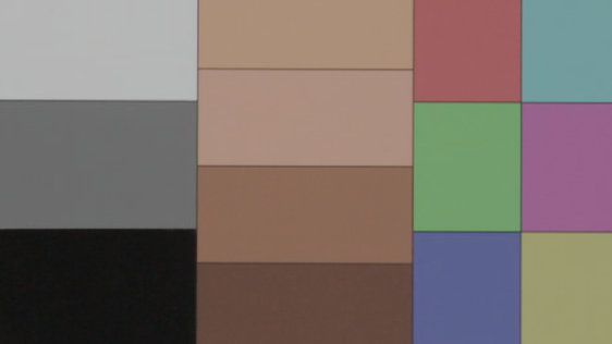

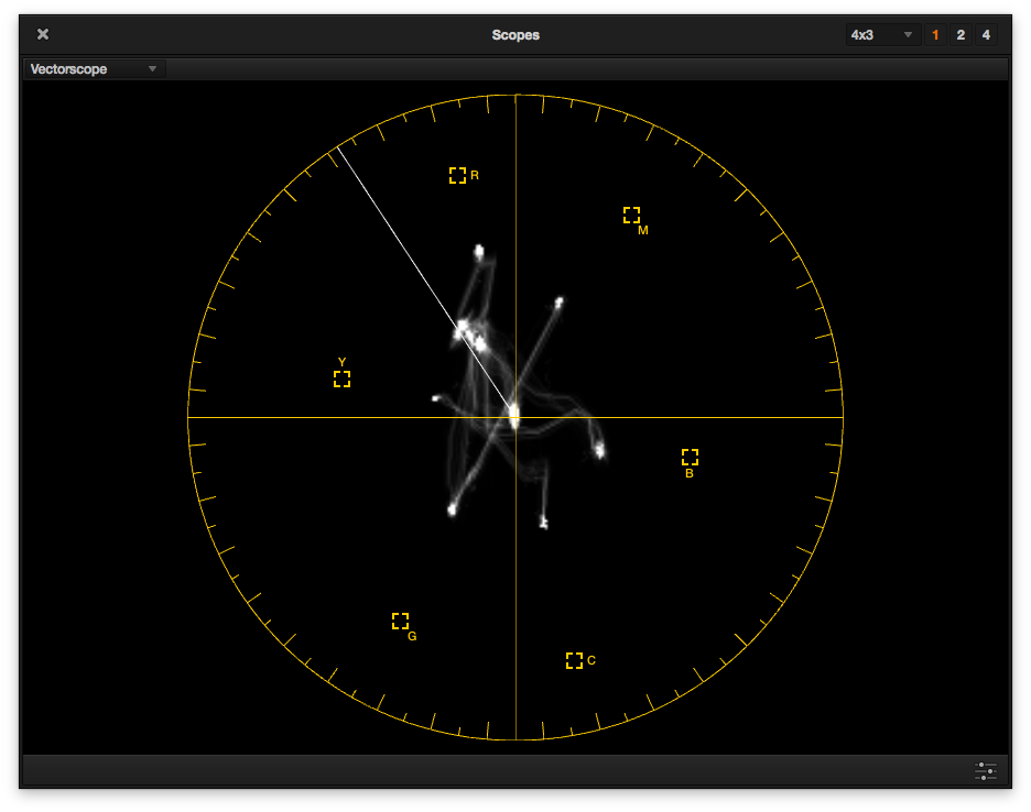

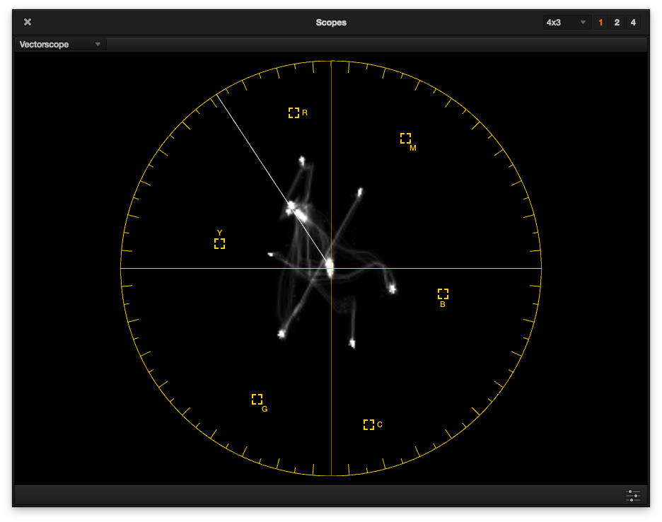

I looked at both LUTs on a color chart and was surprised to see that there wasn’t much difference between the two, other than that the Arri LUT resulted in more saturation:
DSC OneShot chart lit with tungsten light. This is SGamut3.cine/SLog3 without a LUT applied.
There’s almost no difference. If you look at the flesh tone reference line (between yellow and red) you’ll see that two of the flesh tone patches straddle that line in the Sony LUT while one patch is shifted directly onto that line in the Arri LUT. Also, the saturation of the Arri LUT is higher than the Sony LUT. Other than that… I see virtually no difference in color. (Contrast is another story, but we’ll talk about that in a bit.)

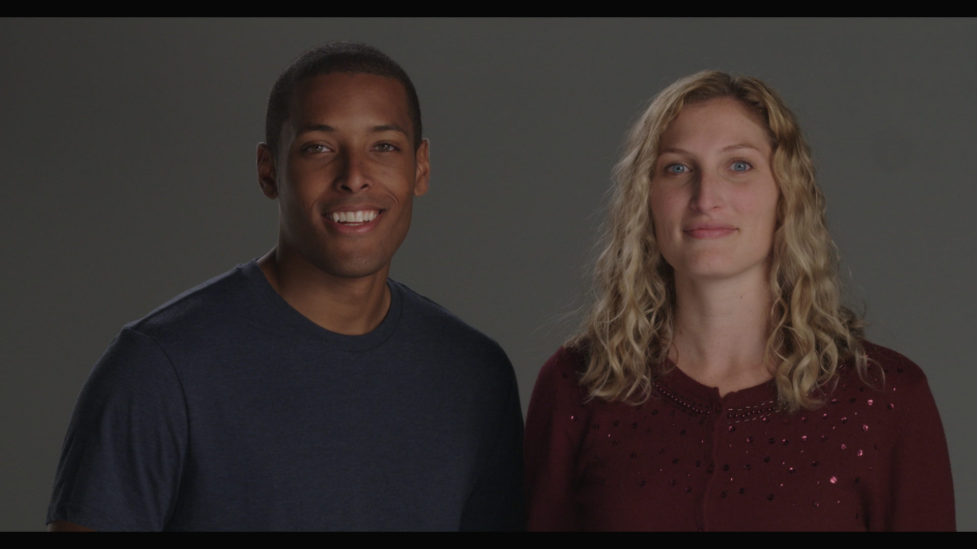

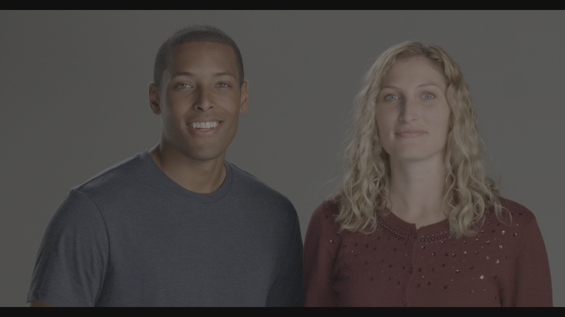

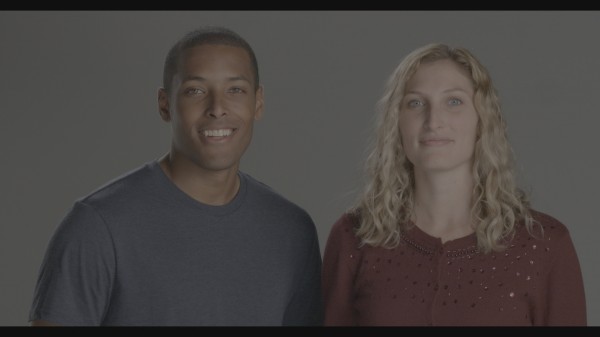

The exception is contrast. The Arri LUT is a lot punchier, and this is easy to explain. When I’ve compared dynamic range between the Sony F55 and Arri Alexa in the past I’ve discovered that where Alexa puts two stops of dynamic range between 40% (middle gray) and 80% on a waveform, Sony crams in three stops. That means that two stops above middle gray is going to look brighter on an Alexa because that tone will fall at 80%, whereas the Sony LUT will place that tone around 67%, resulting in lower contrast and darker mid-tones.
During my presentation some of the audience commented that they thought my footage looked about one stop underexposed, even though I’d based my exposure off a properly calibrated and lit middle gray card. I believe this difference in dynamic range distribution is the reason for those comments.
Based on what I see here, there seems to be zero reason not to apply Arri’s LogC to Rec 709 LUT to SGamut3.cine/SLog3 footage. It looks great, and it’s a punchier look than LC709 Type A offers out of the box. It’s very simple to grade LC709 Type A to be a little more contrasty, but in this age where editors are often asked to “grade” footage but rarely do more than slap a LUT on it and call it a day, it’s nice to have prebuilt options. I’ll certainly be adding this trick to my collection.
