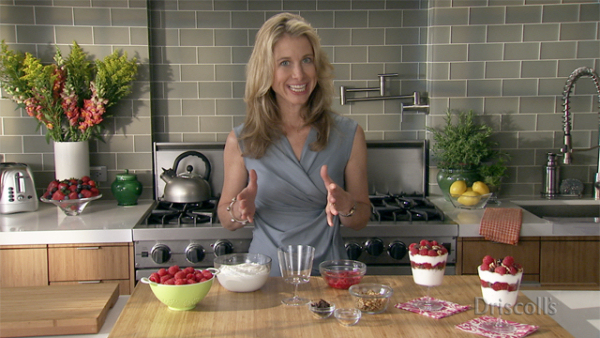

A year or two ago I shot a series of spots in the style of a multi-camera cooking show. We used two Panasonic HDX-900 cameras, and while they were a pain to light for (their overexposure latitude was extremely limited and I had to use dots and fingers all over the set to prevent white objects from blowing out) they made the set look like a watercolor painting. The clients kept commenting on how beautiful everything looked. We shot in a kitchen lined with muted green tiles and their color was dead-on perfect on the monitors. Most cameras would distort them by making them more saturated or shifting them a little toward blue, but what we saw by eye is what the cameras saw as well.
Panasonic took the market by storm with its beautiful but subdued flesh tones and rich, accurate secondary colors. Unfortunately background highlights required a lot of flagging due to limited dynamic range. There’s something about this image that feels “painterly” to me. Shot on a Panasonic HDX900 using one of the “Filmlike” gamma curves under tungsten light.

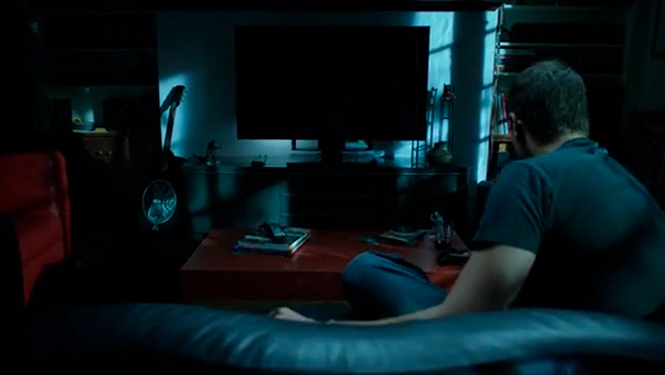

The foreground is graded a touch yellow-green while the background is slightly cyan, creating a marvelous layered effect. Shot on a RED One M, rated at ISO 160, under HMI light.

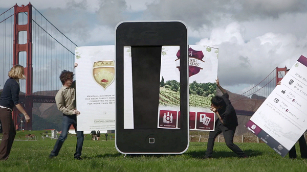

Shot with a Canon C300, EOS Standard matrix with heavy, heavy desaturation. This is the only way I could make the bridge look the proper color and create the subdued color look I love so much, as EOS Standard is VERY saturated.
In the end I went with EOS Standard as the color of the bridge is quite iconic and it would be weird for a regional commercial to show it as having the wrong color.

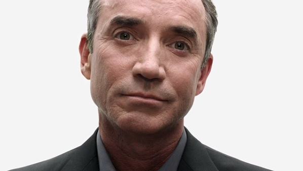

In this talking head video, which I shot under HMI light with a Canon C300, I took a different route and used one of the Cinema matrices for subdued but pretty flesh tones. Unfortunately this color matrix adds cyan fringes around bright highlights. The splotches of light in the background are windows looking north into sunny downtown San Francisco. I’m told that Canon’s latest firmware contains a Wide Dynamic Range mode that desaturates highlights above 70%, which should eliminate this problem.

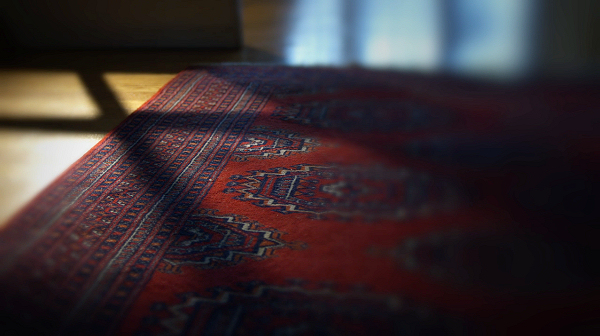

I saw further changes in the F35. During a spec pot shot in a house in San Francisco I found my video engineer staring at a Persian rug on the engineering monitor and muttering, “I’ve never seen such amazing reds before.” The color red in standard definition was always the bastard stepchild: it was never the proper color, or many subtle hues of red were crushed into one generic red wash. The F35 captured all those hues and managed to reproduce them accurately on a Rec 709 display. That was pretty amazing for the time.
Also, shooting daylight under a tungsten white balance looked very different. Daylight read as a much softer and more pleasant blue than I’d seen in previous Sony cameras, and I stopped being afraid of shooting tungsten interiors with a little daylight coming through the windows.

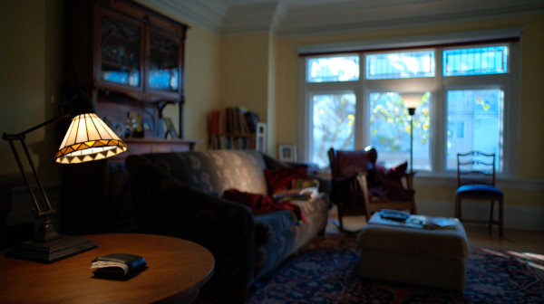

Sony F35 balanced for tungsten light, with daylight in the background. It really is a beautiful looking camera.

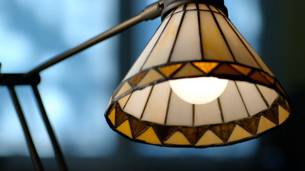

I didn’t know this at the time but I was seeing the benefits of a camera with a wide color gamut sensor. Apparently all single sensor cameras are automatically wide gamut: three-chip prism cameras pass very narrow swathes of red, green and blue and it is difficult to manufacture prisms that pass the broader notches of spectrum necessary to reproduce a wider color gamut, while it’s actually difficult to do the opposite with single sensor cameras. The dyes on single sensor photo sites seem to be automatically wide gamut friendly.
Working with a wider color gamut means the camera is able to see color in a manner similar to what the human eye sees, while prism cameras tend to have significant gaps in the colors they can see which reduces the accuracy of secondary colors. (Panasonic was the only company that made prism cameras that saw secondary colors really, really well.)
There’s an interesting side effect to this: the broader bandpasses of the dye filters used in single sensor cameras made them susceptible to severe color shifts under broken spectrum light sources. Fluorescent lights, for example, show a massive spike in the green portion of the spectrum that film sees but prism cameras don’t, as the spike falls into a color “blind spot” created by the narrow bandpasses of the prism filters. I often used unfiltered tungsten lights in warm white fluorescent environments and they mixed very well when shot with prism cameras. Single sensor cameras see that green spike in the same way film does, which means either replacing fluorescent tubes with color correct lamps or gelling tungsten lights green to match.
I first noticed this effect on the RED One, but the F35 was susceptible as well. I don’t know of a single sensor camera that doesn’t see fluorescent lights this way.
The thing that prevents the image above from looking “filmic” is that the highlights are too saturated. The blues and greens outside the window are much more saturated than film would allow. There’s a new look profile in the F55, LC-709 Type A, that reduces highlight saturation in a film-like manner. I’m quite excited to see how it works with their new SGamut3 color science, especially as I contributed a little bit to Type A’s development.
