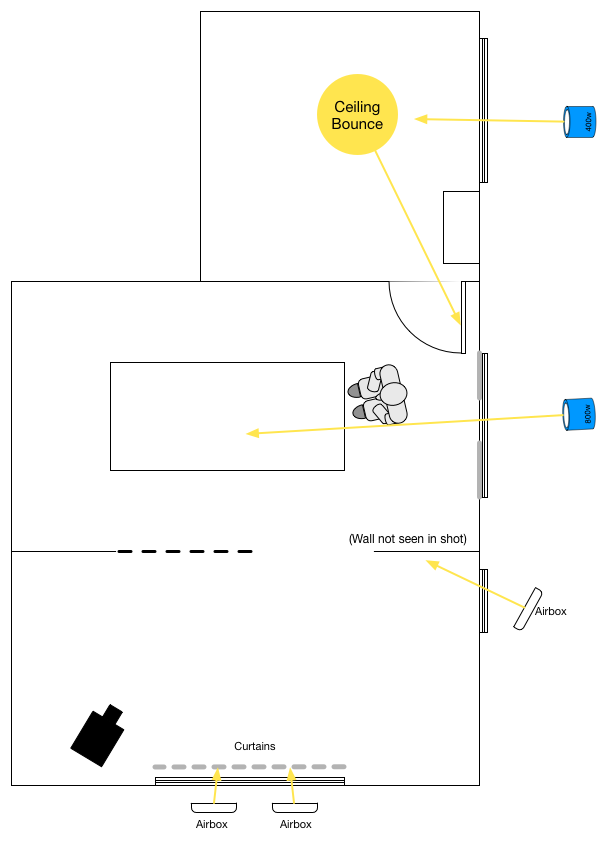

My goal was to light the dining room with a single light, although we used additional units in the kitchen and outside the living room. Tom placed an 800w HMI PAR about 7′ away from the dining room window, and I asked for a very narrow lens as I wanted as much bounce off the table as possible.
The kitchen, seen through the open door in the background, needed some work so we bounced a 400w PAR off the ceiling from outside the window that was over the sink. The hot spot on the ceiling lit the area around the sink nicely but fell off toward the dining room door, so while the light was very soft it had some directionality: we can sense that the light striking the background door is coming from the kitchen and not from within the dining room.
Tom Guiney is the owner of AirBox Lighting, a company that builds inflatable softboxes for LED lights. They look like inflatable pillows made of half soft frost, and they strap onto the front of all common LED panel lights. The foreground door looked to be devoid of glass, so we put two AirBoxes outside Tom’s living room window to make its curtains a glow. Their reflection makes reveals the glass in the door and adds some texture to the shot, while also conveying the sense that the scene takes place in daylight.
We shot at night for total control, and without the reflection of the curtains in the glass the door felt way too dark… but I needed something dark in the frame so I could observe how noisy dark tones are at different ISOs.
FS7 One Light Diagram

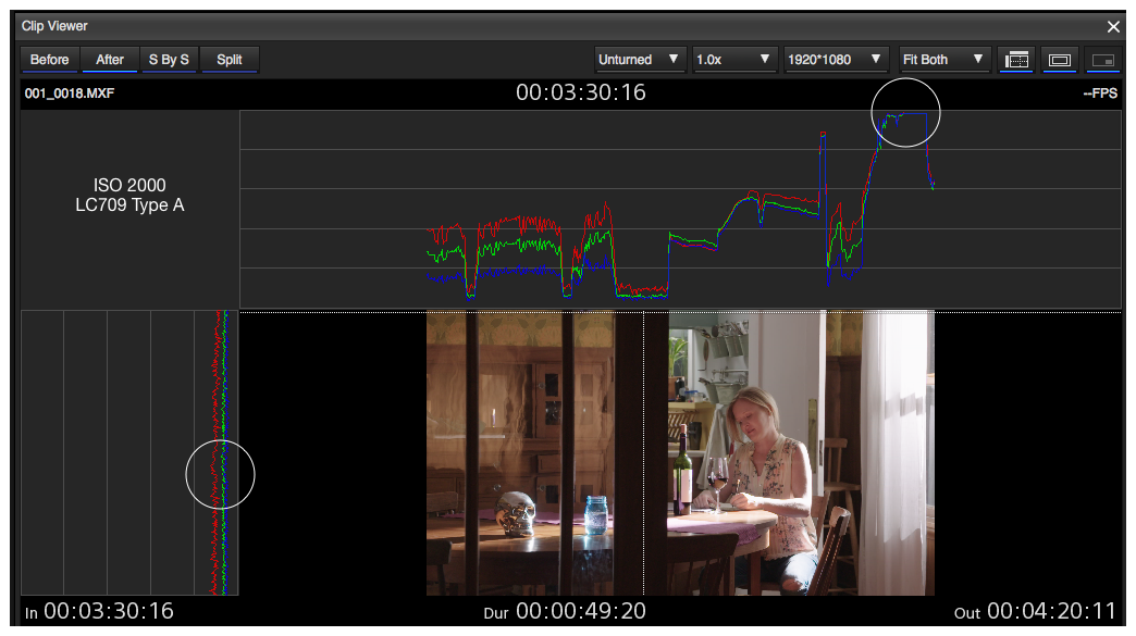

Noise and the number of stops visible between middle gray and white clip go hand in hand, so lets look at some combined waveforms below:
FS7 ISO 1000 scopes
At ISO 1000 the top of the curtains is severely clipped, as seen in the waveform at the top of the screen. The waveform on the left is measuring noise along the vertical line in the center of frame, centered on the wooden frame of the pocket door, while the waveform above is measuring a single horizontal line of pixels at the top of the frame. Watch what happens to the width of the noise waveforms as we increase ISO. (NOTE: This curve clips at around 95% at ISO 1000.)
FS7 ISO 2000 scopes
At ISO 200o we start to see a little detail in the scopes, although the top of the highlight curve is fairly compressed so it’s hard to see any additional detail in the curtains by eye. The noise waveform at left is noticeably wider than it was at ISO 1000, showing increased noise in the shadows. While Sony says that ISO 2000 is “native” for this camera, I don’t like noise in my images so I rate the camera at ISO 1000 when I can. (NOTE: This curve clips at a higher point, probably 98%. LUTs and log curves are mathematical functions, and at lower ISOs the values you feed in max out at a lower level so the function maps them lower. The higher the ISO the farther up the curve values are mapped.)

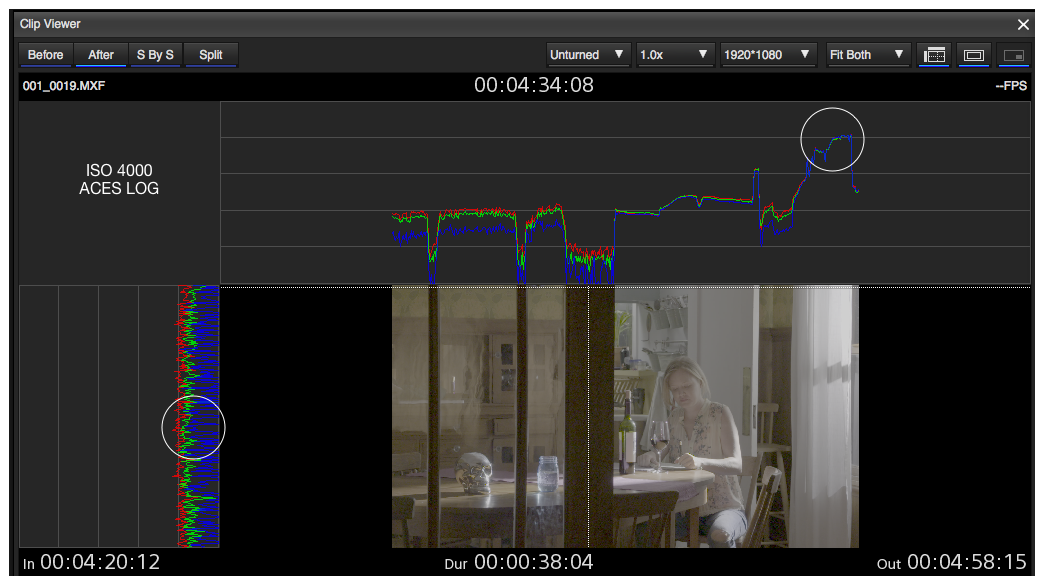

FS7 ISO 4000 scopes
Lots of highlight detail becomes visible at ISO 4000, but the waveform on the left says that noise has increased considerably as well. This is always the tradeoff: highlight retention or amplified noise. NOTE: White is now clipping at 100%.

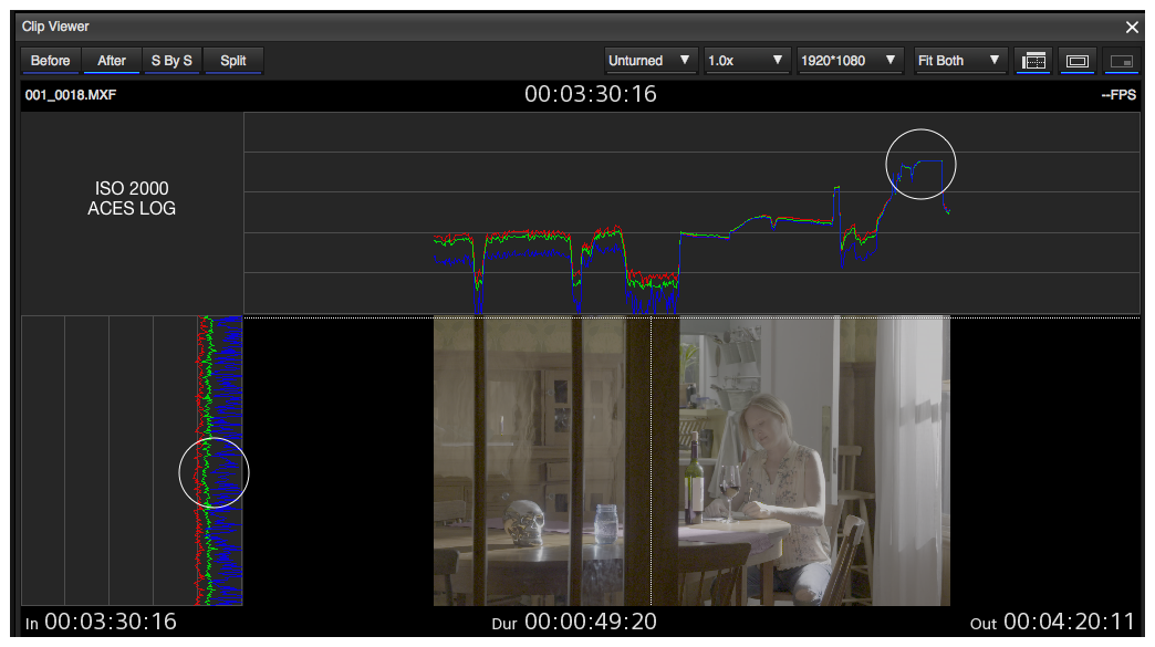

It’s difficult to see exactly how much highlight detail is present here as the LC709 Type A LUT’s curve compresses aggressively toward the top. I found that Sony Raw Viewer offers an ACES Log view, and as I figured there’s nothing flatter than ACES Log I rendered these same images through that LUT to see if it enhanced the amount of highlight detail (and noise) that I could see:
FS7 ISO 1000 ACES scopes
ISO 1000. The ACES Log curve flattens out the image but that’s because it is pushing data at the edges of exposure into the middle of the curve, making it easier to see what’s happening at the boundaries of exposure. The noise looks a lot more intense here but that’s just because it’s been amplified artificially by the log curve; I’ve found ISO 1000 to be very clean. Highlight information has been pulled down to the point where we can see every last bit of highlight detail in the scope. The LC709 Type A LUT wasn’t lying: the highlights are really clipped at this ISO.
FS7 ISO 2000 ACES scopes
ISO 2000. We’re starting to see a lot more highlight detail in the curtains, although the noise floor has taken a hit. The blue channel is a lot noisier, although that’s partly due to the wood having a warm hue (lacking in blue).
FS7 ISO 4000 ACES scopes
ISO 4000. We can now see almost all the highlight detail in the curtains, but the noise floor has come up considerably. I’ve shot at ISO 4000 on city streets at night, and while it’s not bad for certain things it’s definitely a look. It’s pretty noisy.

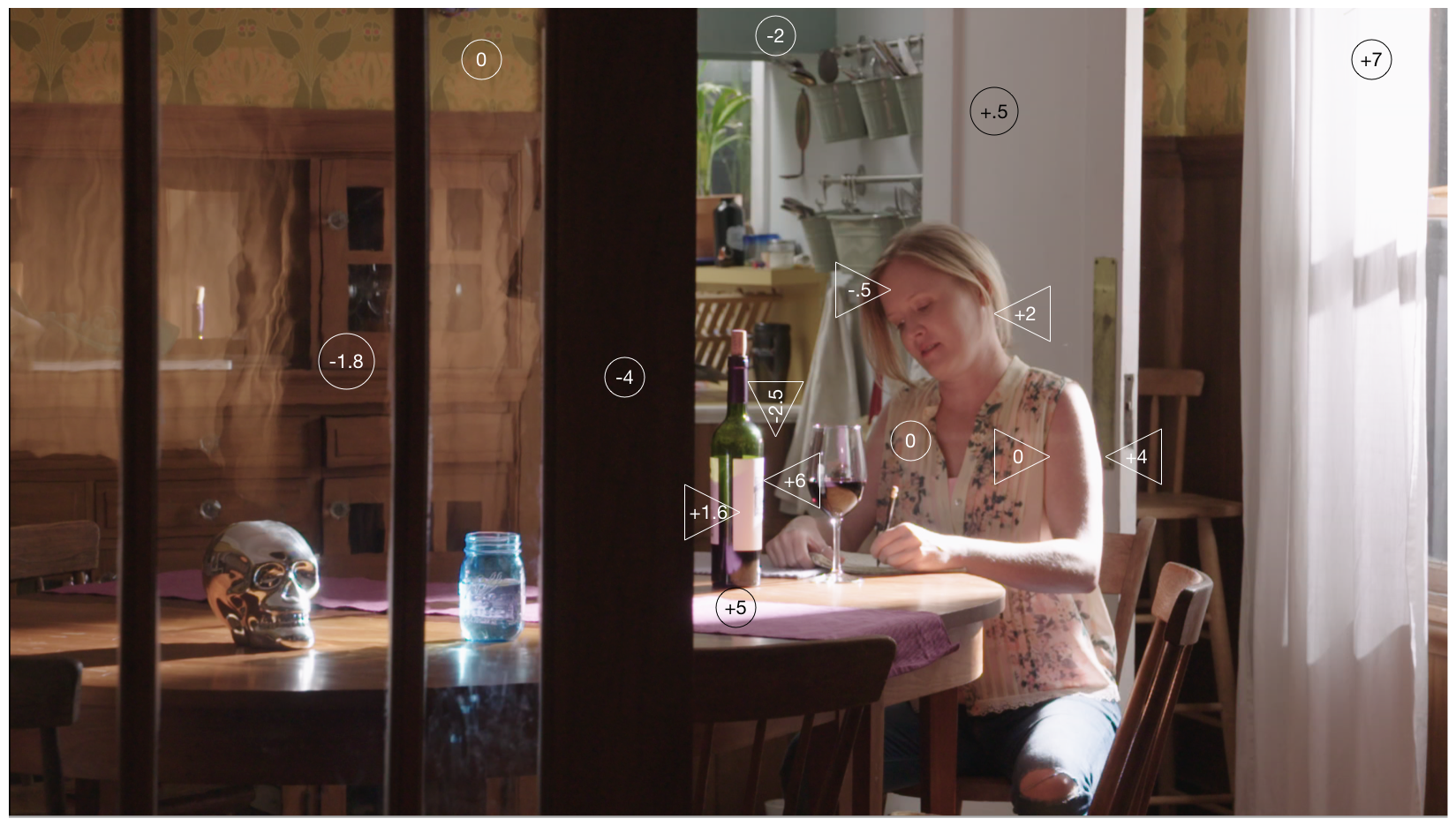

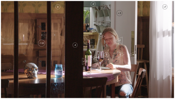

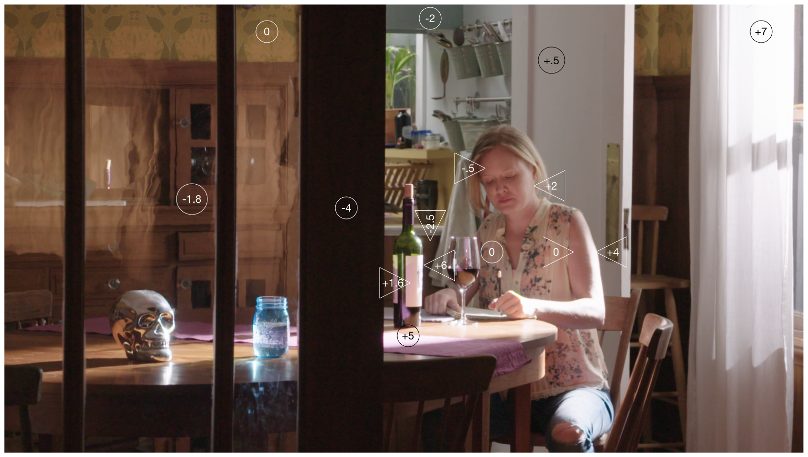

I recorded a number of reflected light readings using my trusty Minolta Spotmeter F (also known as “The best spot meter ever”). Measurements are in stops over and under middle gray.
FS7 ISO 1000 Exp Diagram
ISO 1000. Stop: T4.
ISO 2000. T5.6.
ISO 2000. T5.6.
FS7-ISO-4000-Exp-Diagram-a
ISO 4000. T8.
The top of the curtains appears to change in brightness between ISOs, but what we’re primarily seeing is the fact that the LUT maps maximum values to different signal values depending on ISO. You’re seeing the difference between a maximum white of 96% at ISO 1000 and 98% (ISO 2000) and probably 100% (ISO 4000). (The ISO 1000 value is accurate, but the others are rough guesses based on Sony Raw Viewer’s waveform calibration which appears to show 0-100% instead of 0-109%.) In the video clip section where I circle the highlight on the edge of the table, it’s difficult to see that higher ISOs are capturing more shadow detail because the highlight is also getting brighter as the maximum mapped highlight value increases.

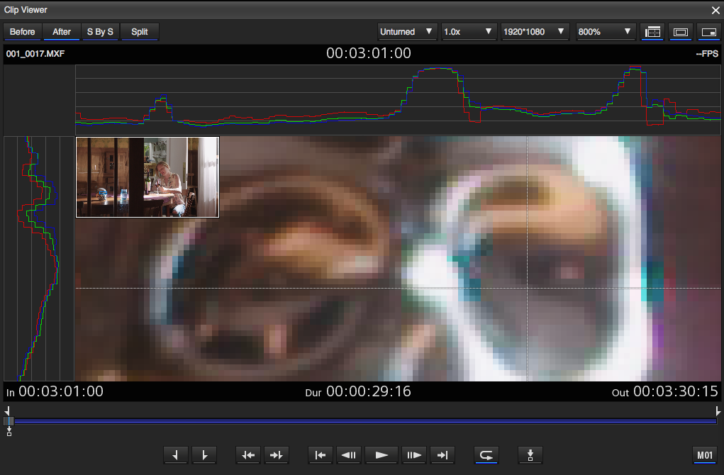

I spotted something a little odd when I zoomed in to a highlight reference that Dan Drasin placed in the shot just for fun:
FS7 skulls artifacts
Those cyan specks are not so much blue/green as they are minus red, as you can see on the waveform above. Directly above each cyan spec the red channel plunges. Adam Wilt tells me that he’s seen this kind of artifact before, and it’s always on the trailing edge (right side) of clipped objects. His theory is that this is an artifact of the live deBayer process required to record it in real time to the internal cards. The externally recorded raw image doesn’t show these artifacts:
FS7 skull raw fewer artifacts
DeBayering after the fact, when processing power isn’t restricted by the speed at which frames must be processed, definitely has its advantages.

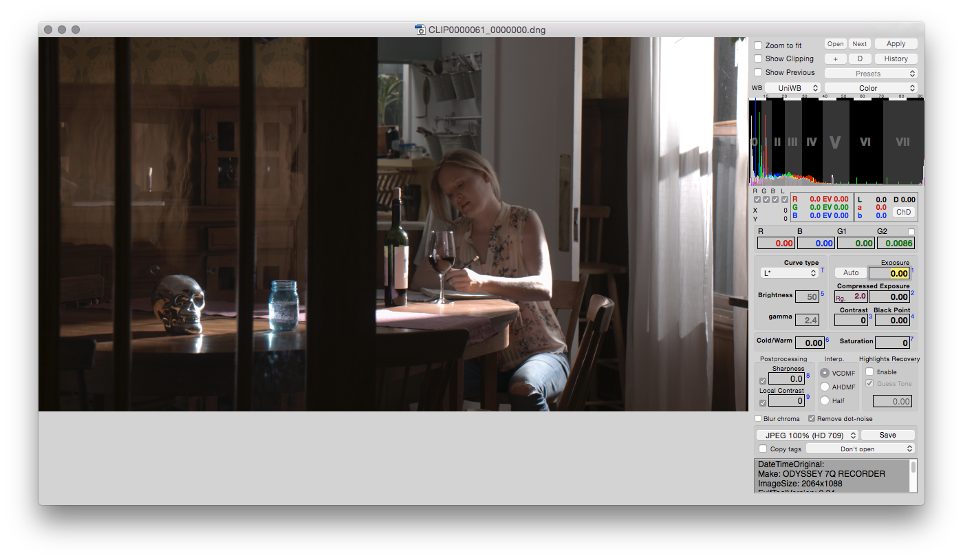

The camera outputs 12-bit log-encoded raw, similar what the FS-700 generates, and as best I can tell it looks pretty good. I say “pretty good” because I’m not totally sure what it does look like, due to the mismatch I mentioned above when recording SGamut3.cine/S-Log3 footage to an Odyssey that was expecting SGamut/S-Log2. When I pulled the footage into Resolve (Sony Raw Viewer doesn’t handle DNG files) I saw this:
FS7-magenta-original
Yikes! No amount of color correction in Resolve 11 could bring this back to normal. I got close when I changed the camera raw deBayer settings to the settings used by Blackmagic raw and maxed out the green gain, but I couldn’t bring the image to a place that matched the color in the XAVC footage. (I’m competent in Resolve, but I’m no seasoned colorist.)
I have a number of still image DNG processing apps on my computer and I tried them all. The only one that worked was Raw Photo Processor 64. When I brought the image in it initially looked like this:
FS7 Raw Converter magenta
Changing the white balance from “As Shot” to “Unity WB” adjusted the red, green and blue gains from their original values of 1.24, 0.98 and 0 to 0, 0, 0, resulted in an image that was immediately gradable:
FS7 Raw Converter normal
I’m still experimenting with these raw files as this raw converter app doesn’t contain a gamma curve option that’s plug-and-play for HD. It has an L* gamma curve that works very well but I don’t understand why: it appears to be some sort of linear-to-monitor gamma adjustment curve, but I can’t find any information on how it actually functions. I understand it’s popular as a monitor calibration standard for graphic designers in Europe.
According to Raw Photo Processor’s documentation, white balance happens at a very basic level when decoding raw footage, which begs the question as to why this was the only app I could find, in either the motion or still worlds, that allowed me to recover incorrectly recorded footage with one simple white balance adjustment.
The settings in Raw Photo Processor are somewhat complex the user interface takes some time to learn, but it seems this app could be useful as a last ditch effort to view and recover DNG images. It offers a batch conversion option that converts DNG files to full swing (full range) or studio swing (legal range) TIFF files in eight or sixteen bits, as well as a Rec 709 JPEG option.
