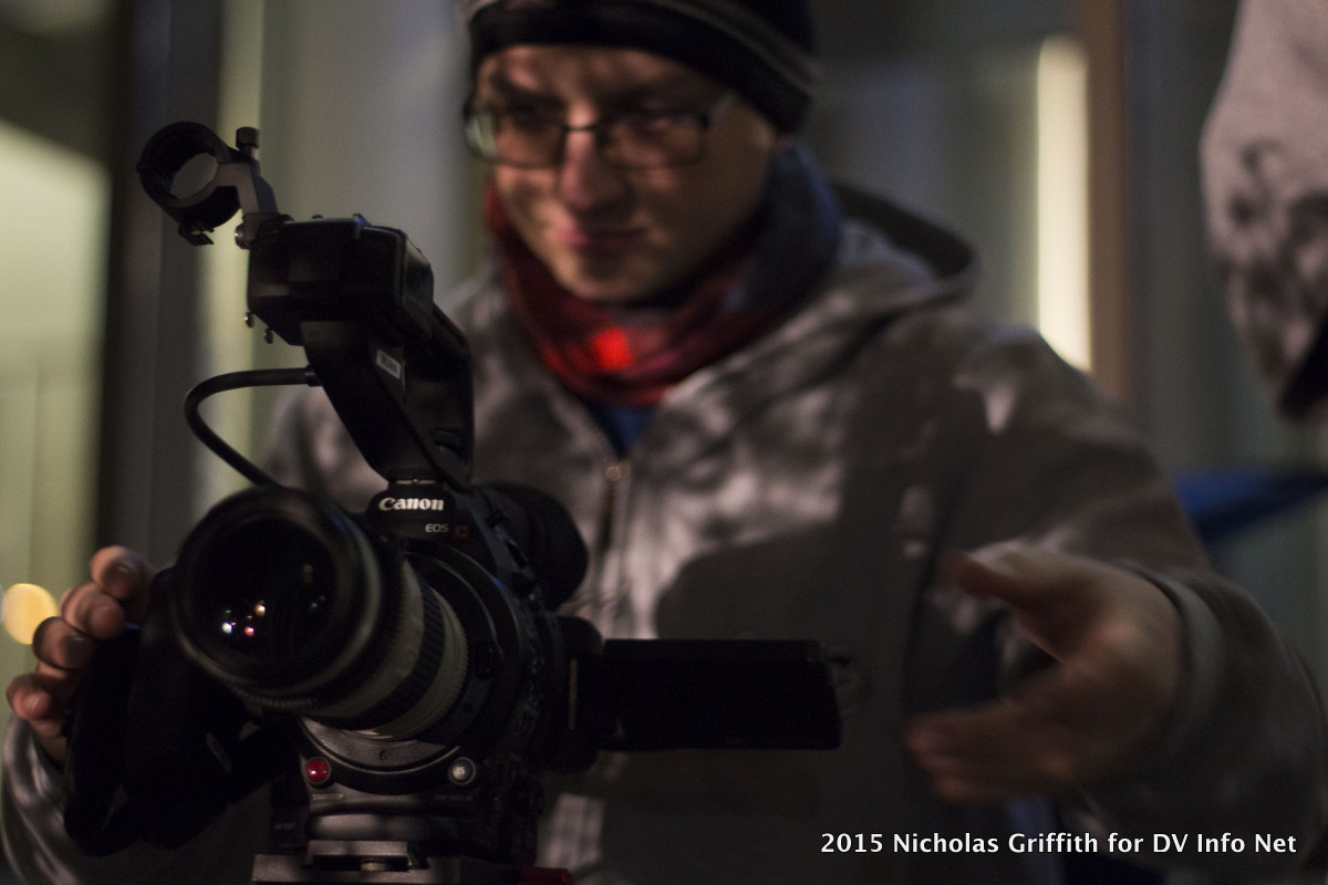

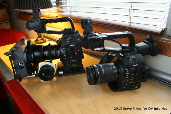

On top of that, it’s a solid piece of engineering. I’ve never encountered a systemic failure or any real problems. I keep the camera built with a matte-box and follow focus as pictured below (alongside the Mark II) in a bag that’s wide enough to accommodate the rig so that I can have it out of the bag and set up quickly.

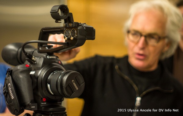

The physical, assignable buttons, viewfinder and OLED screen, all placed conveniently and logically, make operating the camera a pleasure.

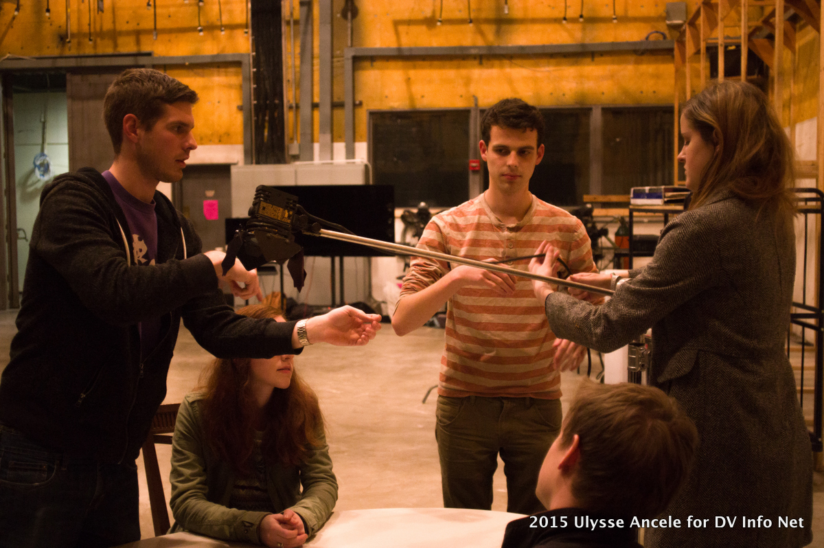

Paul Judah, Seth Beaugh and Katherine Horak set up a 250 watt Lowell Pro on a grip arm in the studio.

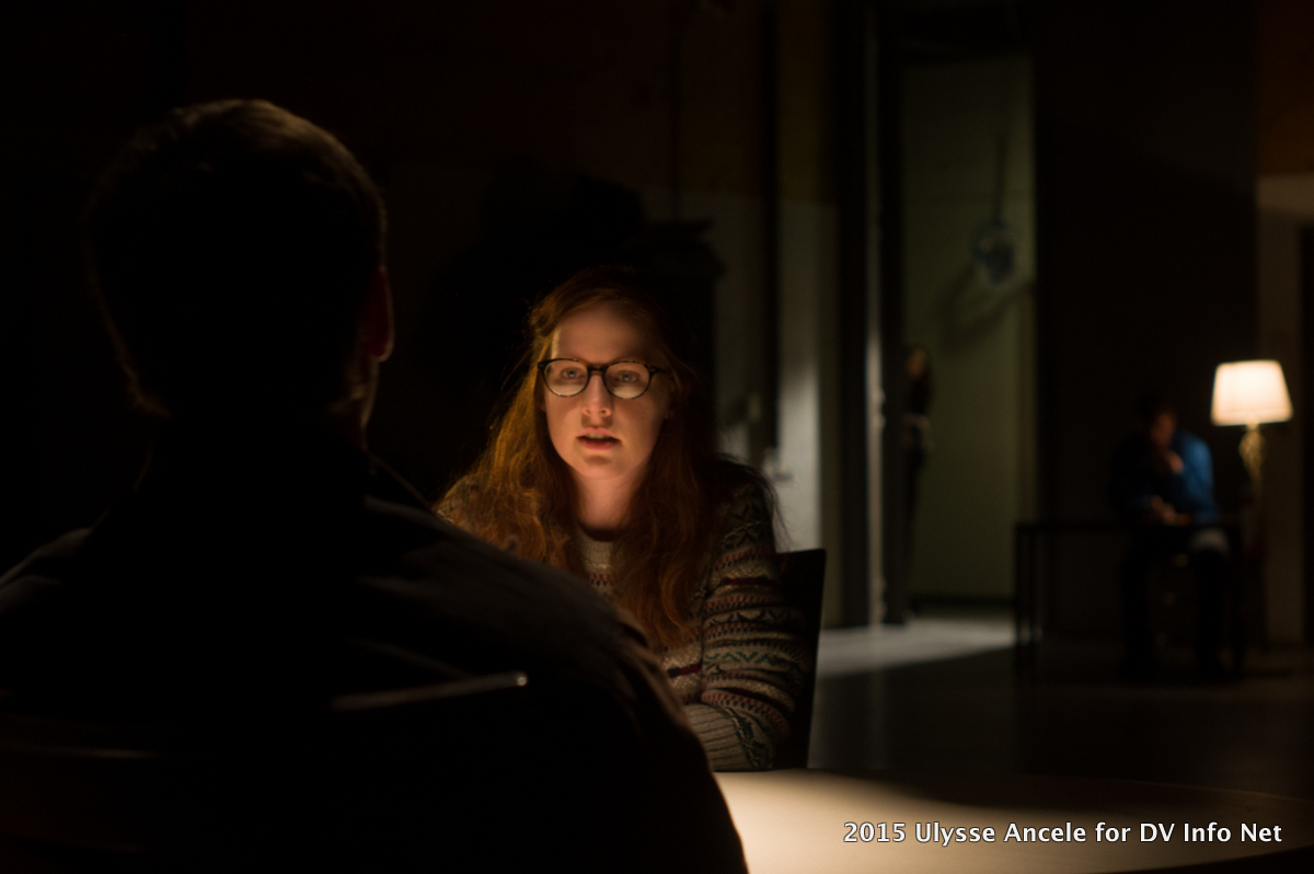

In our STUDIO TEST, we set up and lit a simple scene and kept the ISO at 850. We used two lenses: an EF 24-105mm f/3.5-5.6 IS STM and the EF 85mm at f/1.8 (we had to dial in an ND filter to keep the exposure wide open). We basically had an empty studio with no flats to work with, so we opted to keep most of the room dark. We suspended a 250 watt Lowell Pro from a c-stand over the table, used a 250 Watt Mole Richardson Midget with a snoot and amber gel for a kicker, bounced a 1k into gold foil for a wash on the studio wall and backlit the hallway with an Arri 650. Our talent: Molly Flynn and Pat Murphy, wrote their dialogue in about fifteen minutes, and, I think, acquit themselves nicely in a performance for the ages.

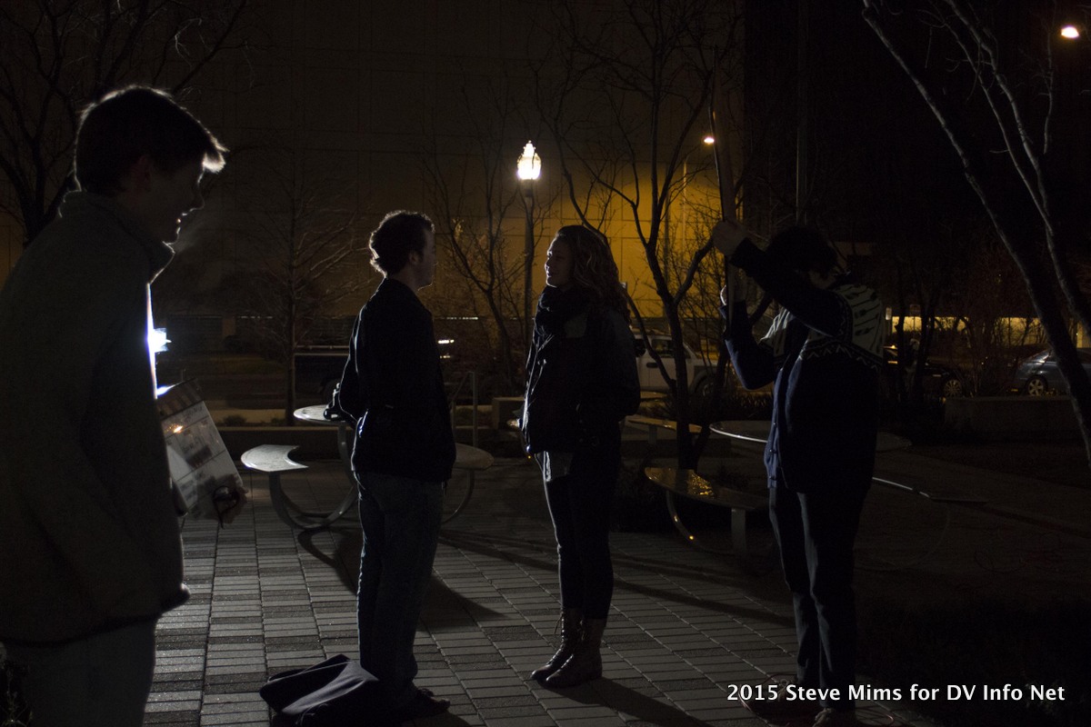

In our HIGH ISO TEST, we filmed in the lobby and exterior courtyard of the University’s Belo Center for New Media primarily in existing light. We did fill one interior set up with a 1k Lowell DP diffused through a Chimera soft-box and bounced on foam core. For the exterior set up we used an Arri 650 Fresnel for a backlight. But basically, we wanted to try the camera in existing light with wide open lenses, bumping the ISO up as needed for exposure.
You’ll see a bit of grain in this footage at ISO 8000. I was impressed with the OLED screen which the AC was able to use to judge follow-focus on the 70-200mm lens. Overall the footage has a natural grain that is more pronounced than ISO 850, but not objectionable for existing light.

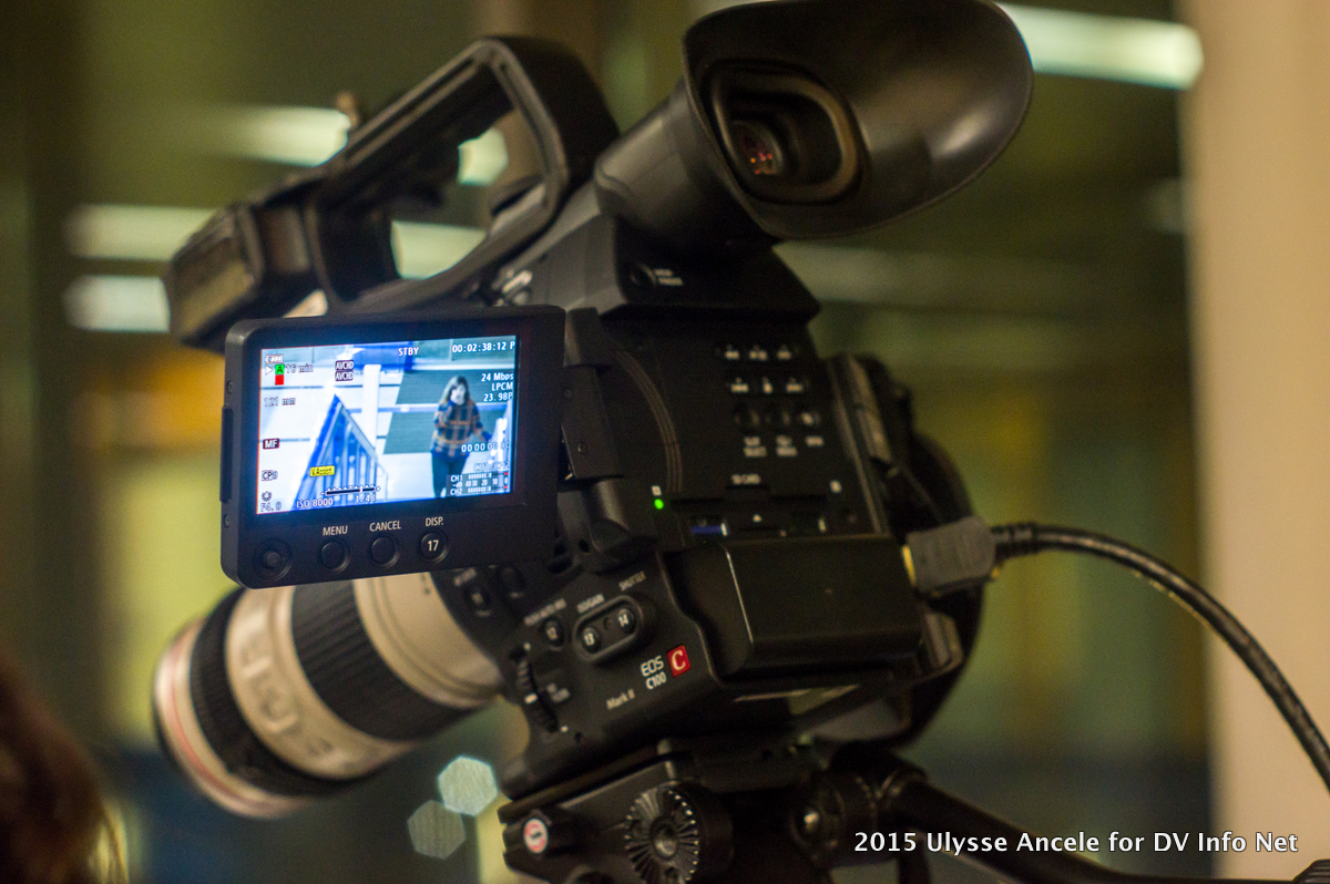

The VIEWFINDER is arguably the one that should have been on the first camera. It’s a pleasure to use: angle-adjustable, bright, sharp and shielded by a real eyecup.
The OLED screen is now sharp enough for use by an AC to accurately pull focus and it folds over on the side of the camera where an AC works. Very nice. There’s no more guesswork about critical focus.
