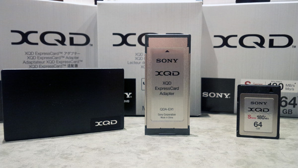

A Sony 64GB SXS Pro Plus card will set you back around $850 USD while a 64GB S-Series XQD card costs around $319 for the 180MB/s card and slightly less for the 168MB/s. For the F5 and F55 Sony has indicated that the XQD cards support all codecs: XAVC 4K, XAVC 2K, XAVC HD, HDCAM SR file, MPEG. An SxS to XQD card adapter ($33 USD) is needed to use the XQD card media in the cameras, and an optional USB3.0/2.0 XQD card reader can be purchased for around $38 USD.

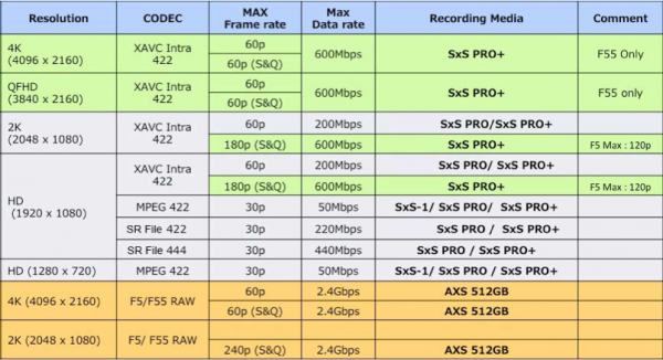

I tested both the 168MB/s and 180MB/s XQD S-series on the Sony F55 using a resolution, codec and frame rate that would produce the absolute highest maximum data rate which is 600Mbps when recording 4096×2160/60p in XAVC. A quick look at the Sony F5/F55 data chart shows there is no other combination of resolution, codec and frame rate on the F5 or F55 that exceeds 600Mbps. So it would stand to reason that if the S-Series XQD cards can handle 4096×2160/60p that all other combinations of settings should also work flawlessly.
If there is still any doubt that these cards have adequate performance to work in various camera shooting modes I suggest that you ignore the codec, frame rate, and resolution, and strictly look at the bitrates you will be working with. For example 4k/60p and 180fps HD in HFR mode have the exact same bit-rate of 600Mbps which is the highest data rate possible on the cameras. Remember the SR codec maxes out at 440Mbps in 30p mode, and MPEG even lower.
