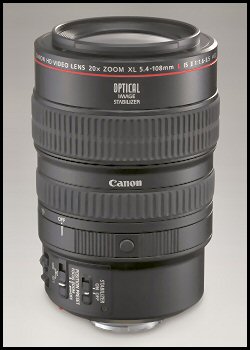

The New 20x HD Lens
The new 20x HD video lens barrel shares the same outer dimensions, control rings, switch panel, 1/6 and 1/32 ND filters, lens hood and filter thread diameter as the standard definition 20x L IS video lens included with the XL2. The focal length of the HD video lens is also the same as the previous SD lens, with a 20x zoom ratio of 5.4mm to 108mm from twelve optical elements in ten groups. As in the previous SD lens, fluorite elements are used in the HD lens. The similarities end there, however. The 20x HD lens is a new optical design incoporating high-refraction glass with a special coating (called “SR” by Canon) to reduce image ghosting. The Super Range OIS (optical image stabilisation) is the same type as used before in the XL series — a bellows VAP (vari-angle prism) system with CCD feedback — however the OIS design is new, with improved frequency sampling. The focus and zoom preset features are brought forward to the HD lens from the SD version, with a new focus preset memory backup function.
Since focal depth is more critical in HD, a newer, more accurate auto-focus algorithm has been incorporated in this lens. Other new features include a six-blade mechanical shutter for still image recording, and a user-controllable flange-back adjustment procedure for backfocus alignment, which can be performed manually or automatically via a camera menu option. The 20x HD lens also provides a numeric distance readout in the EVF display using an arbitrary number scale from 0 to 99. The number of lines of resolution for the 20x HD lens is not disclosed at this time; instead, Canon is stating only that the lens is perfectly capable of resolving to HD quality standards. This lens is backward-compatible with the Canon XL2, XL1S and XL1, but without the flange-back adjustment or the numeric distance readout features. The maximum aperture at the 5.4mm focal length is f/1.6. At full telephoto the maximum aperture is f/3.5. The minimum aperture value before closing completely is f/16. This lens uses a six-leaf iris. The field of view in 35mm still photo equivalents is 38.9mm at full wide to 778mm at full telephoto when recording in its native 16:9 aspect ratio.
Although the standard definition 20x L IS lens and other Canon XL video lenses can be mounted on the XL H1, Canon recommends against this practice as those lenses will not properly resolve for HD. The earlier EF adapter for the Canon XL series is of course fully compatible with the XL H1, and most of the Canon EOS line of 35mm still photography lenses may be used for HD, the caveat being a 7.2x multiplication factor which renders most all EOS lenses to an extreme telephoto field of view. There are no initial plans to offer the XL H1 body and 20x HD lens separately; for now they may be purchased together only as a full kit. Canon states that it will not comment on future products, leaving the question of additional XL HD lens options up in the air.
There are no plans to offer a 1/2-inch lens adapter; standard broadcast HD video lenses may not be used on the XL H1 without serious modification anyway, as the grip handles on those lenses would physically interfere with the grip handle built into the XL H1 body. The P+S Technik Mini35 converter and a variety of other emerging 35mm image converter solutions are indeed as viable with the XL H1 as they are on the XL2 and previous XL-series camcorders.
