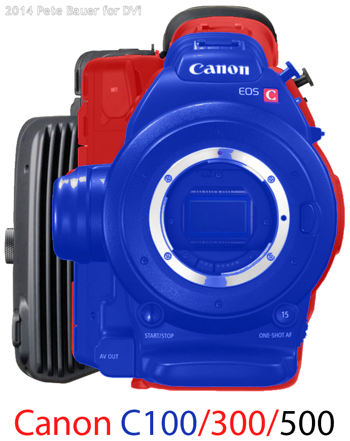

Body dimensions (mm) | 135 x 170 x 129 | 133 x 179 x 171 | 160 x 179 x 171 |
Full config. dim. (mm) | 182 .x 281 x 263 | 175 x 284 x 301 | 185 x 284 x. 301 |

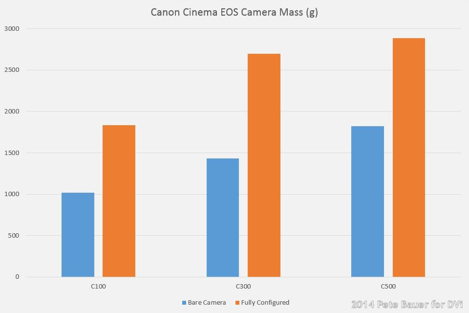

EF cam. body mass | 1020g | 1430g | 1820g |
Full. config. cam. mass | 1835g | 2700g | 2885g |

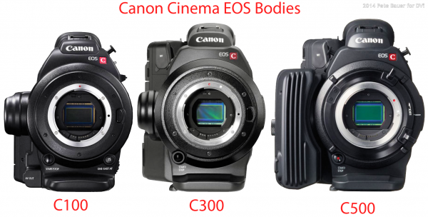

C100 Overview
The C100 leaves a light footprint. It is built on a smaller frame than the other two and is distinctly easy to handle. It even uses the same smaller CA930 to power the camera and charge the battery, whereas the other cameras have separate and heavier adaptors and battery chargers.
While it lacks the ability to jam timecode, and it records AVCHD rather than MXF, the C100 has more ENG / run-n-gun features like Auto White Balance, the newly released optional Dual Pixel continuous autofocus, and a built-in microphone in case you want sound but don’t particularly need to set up external XLR microphones. My subjective experience was similar to what others have reported on the forum: I liked the button layout of the C100 even better than the C300, although I must admit that I missed having default headphone volume buttons as the C300 does. Not a big deal, though, as that is one of many functions that can be assigned to a button.
Many others have complained about the small viewfinder. Yes, it is a bit of a step down from the bigger one in the other cameras. I have mixed feelings about the rear-mounted LCD. In some situations, it worked well whereas at other times I would have preferred the modular, adjustable C300/C500 display and handle setup. Then again, others have complained about the C300/500 LCD because they didn’t want to use it in the first place but had to attach it anyway because that’s where the XLR jacks are. Since the LCD is rear-mounted on the C100 camera body, the handle/XLR attachment is small and handy.
One nit that I think must be due to the AVCHD recording format is that there is no menu function to set a custom file naming sequence as can be done with the cameras that use MXF. In the XF cameras or C300, I found it handy before a shoot to set the file names to start at say, PB0001. I don’t see a way to do that in the C100.
Of course, many folks choose to add an external monitor/recorder to their setup. Either out of the box or dressed up, at just $5000 ($5500 with Dual Pixel), it is the one to choose for one or two camera non-broadcast production.
C300 Overview
Moving to a price point of $14,000, the C300 has become a popular go-to camera where MXF files, jamming timecode, or plugging in to a multi-cam HD-SDI setup are called for. However, like the C100, 30fps or 59.97i and 4:2:2 is the most you can get out of this camera at 1080 resolution, even with external recorder.
It is physically bigger and heavier than the C100 but still fine for handheld shooting. Neither the C300 nor the C500 have any sort of built-in microphone. If you want sound, you’ll need to attach an XLR mic.
Although to a somewhat lesser degree than the C500, this camera’s design gives a nod to the assumption that the filmmaker will set up the shooting environment. For example, the operator must choose either a preset white balance or set a custom color temperature; there is no Auto White Balance. I’m pleased to see that the Dec 2013 firmware revision added Lens Exchange via any menu-assignable button. I wouldn’t think that my mentioning the need for this to a Canon rep in October had any effect on it being added to a firmware release just two months later, in December, but I’m glad to see that Canon provided this feature, as I think it is likely more valued in the C300 than the C500. Canon is continuing to improve the cameras, promising that the optional Dual Pixel continuous autofocus will come to the C300 in May 2014.
C500 Overview
Even though it is built on the same main body as the C300, the C500 is overall a little heavier and wider. In place of the removable handgrip that is part of the other two cameras, the area where the handgrip attaches to the C300 body is instead populated by dual 3G-SDI, two external monitor BNCs, and what I am assuming is a little extra internal space for the associated 4K electronics. The handgrip from a C100 or C300 can be plugged in to a terminal on the C500, but is not an “in the box” accessory and does not affix firmly to the camera body to allow for handheld use as with the other cameras.
This belies the tradeoff: In exchange for “big-movie” abilities; this camera is not really optimized for grabbing a run-n-gun clip. From connecting external 4K recording to custom color temperature to setting manual iris to pulling manual focus to setting custom LUTs using a dedicated button, it is all about the prepared shot.
This is the one camera that has a dedicated Lens Exchange button, allowing lens to be changed without powering off the camera and losing accuracy on a jammed timecode (see further discussion on that in this post).
Even 4K aside, though, the C500’s ability to send HD up to 120p (actually 4096 x 1080 cropped RAW) out to an external recorder can be tempting. I can imagine that would be tremendously useful for sporting events. The cost of entry is high for smaller shops, though, at $20,000 for the camera plus whatever your external recording system costs.
